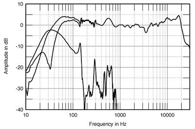

The mains are 93dB/watt/meter and the surrounds are 92dB. The amp should be capable of about 110watts (Denon 3310CI, rated at 120watts) in my 5 channel setup. Here is the frequency response chart for my mains:

I agree w/ Zing. I would set the cross-over around 60Hz and let my sub do the best job it can do. If you upgrade then you'll get the extra oomph you're looking for. Your mains and surrounds simply won't give you what you're looking for in the bottom end. All that will really change if you continue to lower the cross-over frequency is blurred mid-range because of the issues we discussed on the other forum.
